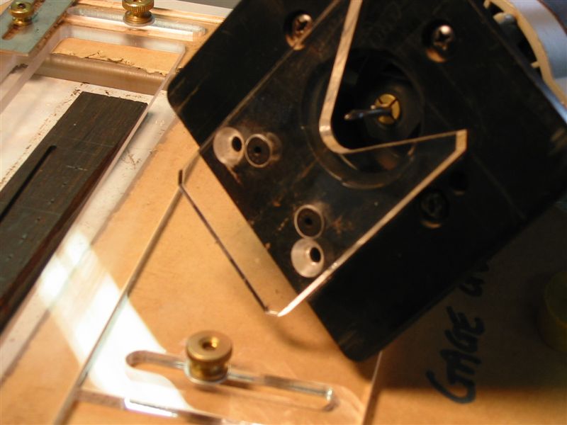

I was skimming a thread a few days ago, where there was some talk about using the stew mac saddle slotting jig with a lam trimmer.
heres what I did, I got an 1/8" to 1/4" conversion collet and a 3/32nds down spral bit, and drill and counter sink new holes to fit my porter cable.
works like a charm.... hope this is usefull info

I haven't tried using one of those adapter collets yet, and was wondering how well they work.
BTW, spiral bits (upcut and downcut) in sizes down to 1/8" are available with 1/4" shafts. I'm just adding that tidbit of info for anyone who may think the only small spiral bits are those 1/8" shaft ones you can get from Stewmac. I haven't seen any 1/4" shaft bits as small as 3/32", so if you want to use a bit that size or smaller with a lam trimmer, the only option is to use an adapter collet as far as I know.
